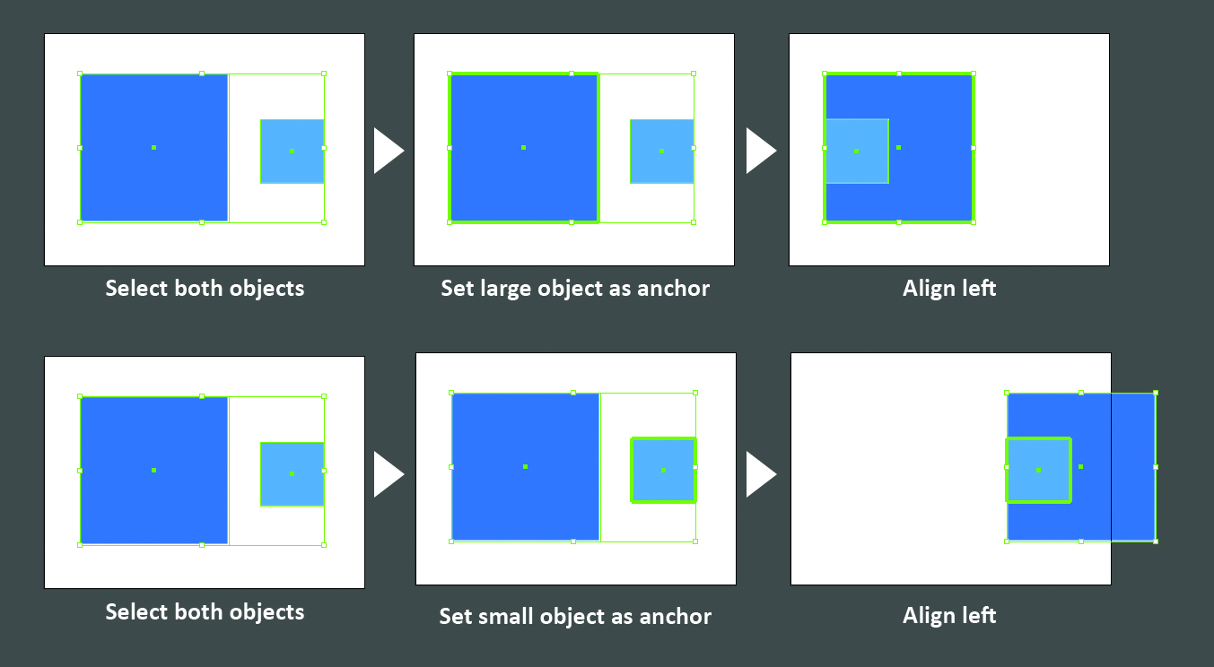

I think what Zachary is referring to is Illustrator's ability to align to a 'key object' (as in attached screenshot).
Once you've selected your objects to be aligned, you can click one again to specify a key object (shown by a bold border). Then when you hit any of the align keys, the second object will be aligned in relation to the key.
This would be super handy in Lectora, as it's hard to tell which object will be moved to align to the other, or whether both will move and meet each other in the middle - can make it very difficult to center objects on a background element (like a carousel card) as often the object you want to align to will move as well!
