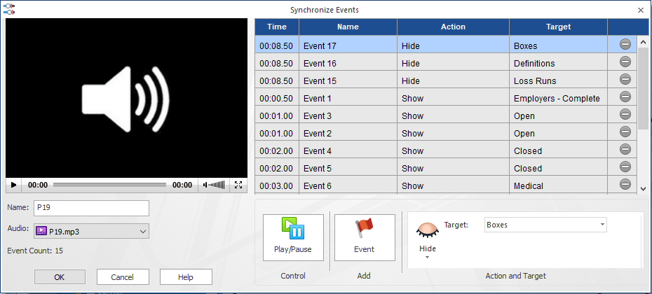

Is anyone else having major issues when using events timed to audio tracks? If I adjust the timing of an audio event in the events list, it bumps it to the top of the list, regardless of the timecode of the event and no longer plays whatever action is assigned to the event. When creating a new event and inserting the time code for the action, half of the time this behavior occurs too. The only way I've gotten the timed events to work is to assign an event as the audio is playing and then never, ever, ever, ever touch the timing of it again.
This makes it rather impossible to adjust the timing of events linked to audio tracks. Since Lectora only shows you the seconds on the audio play bar, there is really no way to fine tune anything. You just have to guess and try, guess and try, guess and try. Any advice on what I'm doing wrong would be appreciated as I can't express how many hours of frustration and lost productivity this has cost me, nor can I believe that Lectora would publish a product and tout this feature when it's, well... rather broken.

In the attached mp4, you’ll find an audio track with four synced events. Event 3’s timing was changed from 11.50 to 9.30. Upon finishing the change, the Synchronize Events list moved the event position from last in the list to second on the list. The event now no longer works and even though the line of text is set to initially hidden, it shows when the page shows. undefinedspan style="color: #000000; font-family: Calibri;"undefined
In addition, if you create an event before the audio track plays, meaning the event will have timecode 00:00:00, and then change the timecode to what you want it to be, it will not move to the correct spot in the list based on it's time code. It just stays at the top of the list with the timecode you entered and the actions you assign do not fire. I battle with this every single day since all of my events and actions are synced to audio tracks. It makes things a nightmare. You can find an example of this in the attached png.

Robert: you might try a stable version of Lectora. 17.1 is weirdly and (frankly) unacceptably buggy. Revert to 17.0.6.
Have to agree with Carl on this on. 17.1 is unstable. Cannot get a decent title published, whereas 17.06 works fine. I am afraid Trivantis developers are focusing on getting 18 out before the end of the year, so donot think 17.1 will get a decent update.
Nice to know I'm not insane. Ill give tech support an email and see how I can roll back to the previous version. I create about one eLearning module a month, and would not want to have to slog through another four or five this way.
