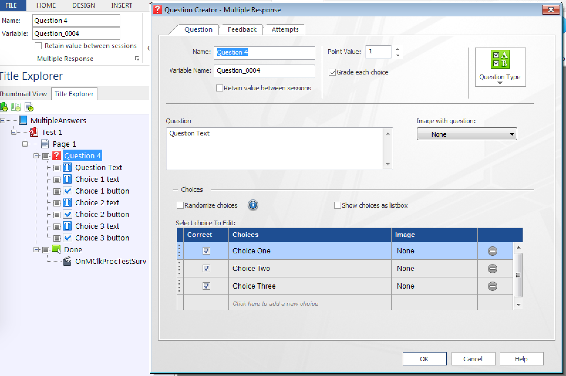

In fact, all you need to do is to enable "Grade each choice" in question settings and mark all answers as correct. Then EACH CORRECT answer will be worth 1 point and your whole question will be worth 3 points. See screenshot.
Since questions are scored only as part of a quiz, you will have to add them to the quiz. Your learners will get 0%, 33%, 67% or 100% result depending on how many correct answers they select.

What I am saying, you cannot see in Lectora how many points someone scored in your question (0, 1, 2 or 3). Instead, you can wrap this question in a quiz and see how many %% the learner scored, i.e. 0%, 33%, 67% or 100%. Which gives you the exact same information, only in a different format.

I should have considered the "Grade each choice" option a little more carefully. I guess it effectively turns each answer into an "or/and".
I'm not sure I follow the percentage example you gave, maybe I'm getting my wires crossed (excuse me, it's been a long day). How does the point value relate to the question, or overall quiz score as a percentage?
I might be misunderstanding the fundamental scoring system for tests in Lectora, if that's the case, please don't spell it out for me. I'm happy to seek out the applicable documentation and do some reading!
Thanks again Sergey,
Benjamin.
Ah ha.. that makes perfect sense. Thanks for taking the time to explain Sergey, much appreciated.
