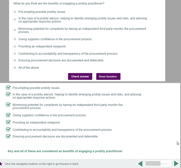

Our pilot / testers all hated that auto pop-up box. So we changed the feedback to a layer that appears within the window itself, and then doesn't present that extra click.
See attached example of the question, and the feedback
