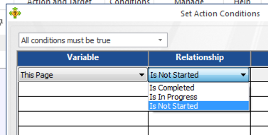

I would like to see compound conditions, so I can set up something like this:
(Chapter "Is Completed" OR Chapter "Is In Progress") AND var_MenuType "Equal To" Forced_Order
I resolved this by setting up two actions, but it would be a nice to have, if I could do it in one. (Or in this particular example, it would be nice to have an "Is Not Completed" scenario. :-)

it would be nice to have an “Is Not Completed” scenario.
I think the "Is not started" condition is exactly what you need ;)
All:
Yes, compound conditions using status is a little more difficult. As Roz suggests, it's not easy to test "Is Not Completed" (meaning the target has not been started by the student or is still in progress) AND another condition. But I'm happy to say that will all change with the next version of Lectora and Lectora Online! As Sergey suggests, there will be "inverse" conditions for status:
In addition to the current relationships:
- Is Not Started
- Is In Progress
- Is Completed
You will also have available:
- Is Started (meaning the target is either In Progress or Is Completed)
- Is Not In Progress (aka Is Not Started or Is Completed)
- Is Not Completed (aka Is Not Started or Is In Progress)
Daryl
